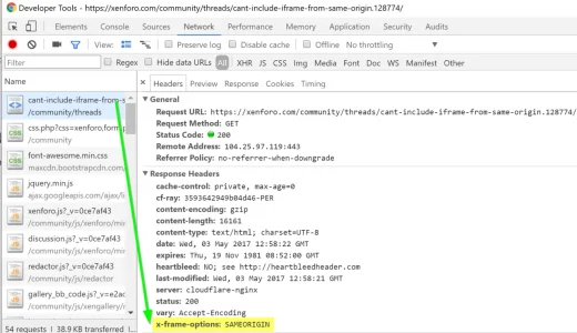

Can you check your HTTP response headers in your browser (e.g. Chrome network tab) when browsing normal XF threads? I checked both here and on my board, and default for this is: x-frame-options: SAMEORIGIN
It sounds like your header has been explicitly set to Deny ?

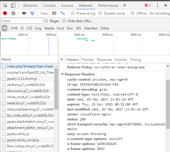

Im not sure where I can see the response headers you need to know but could it be that cloudflare sends this header?

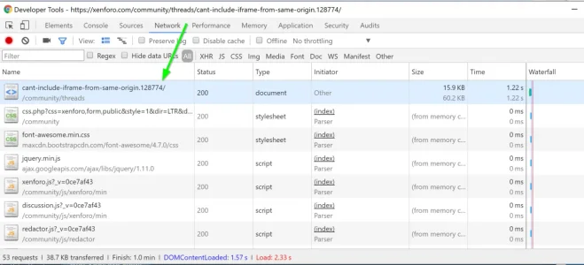

In Chrome open up the Developer Tools with F12, then go to Network Tab.
Refresh the page. Then scroll up and find the page, using this XF thread as an example:
Would be curious to see what that header comes up with on your page..
Yeah that's definitely not right.. the fact that you mentioned it was working fine earlier would mean something must have changed in your server config?

Thank you very much for your responses! After you mentioned that something must have changed at my nginx configuration and I remembered that I added a config for 2048bit ssl encryption and that config forced the header DENY. after changing this it works now fine.
