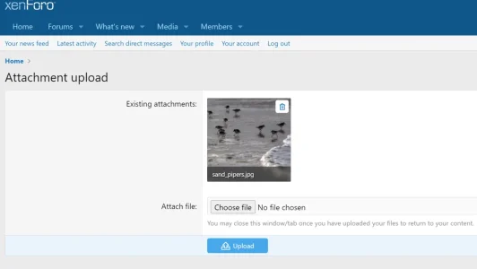

Installed a clean version of XF 2.3b1 with XFMG 2.3b1, I can upload images fine into a forum post, but it won't create a Media Gallery entry.
I have tried PHP v8.3 and PHP 8.2 and used recent Chrome and Firefox, but it doesn't ask for the media gallery title, description, caption or tags, it just sits at the screen shown below.
I can view the attachment in the Admin, Content, Attachments section, but it shows up as "Unassociated"
No errors in the XF logs, using default style (no addons installed, only XFMG)
