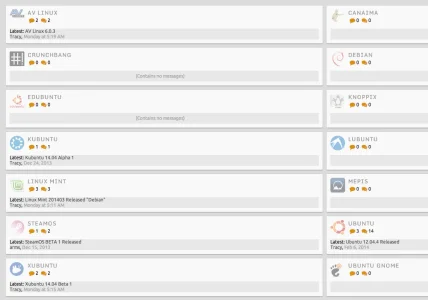

It's very easy to do. As @Amaury stated, once you register you will be able to review the resource to do it. Below is a sample of my Linux forum. The reason the images look dim is I add an opacity to them of .4 for read areas for the icons and opacity of 1.0 for unread - that way I use the same image for both. Once I get the entire site configured I'll be placing those into a sprite sheet and serving them from that.when I click to "open image in new window" over the icons for XenForo I don't get that option so it looks to me like the icons are not editable on a forum by forum basis
It's very easy to do. ...
Well I followed all the instructions available here on the forum, and like others all I achieved was a mostly blank space where the icon should be.
