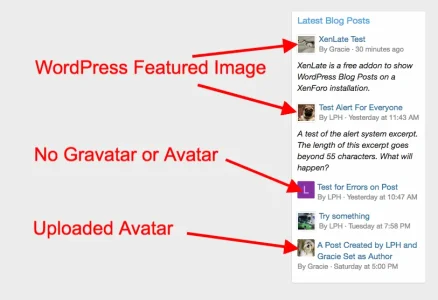

Thank you both. I've added the getOptionsTempate() and set it to null. I'm now getting the widget showing and the WordPress blog posts showing in the widget. Wahoo!
The CSS needs work and some of the conditionals in the templates need to be updated. For example, if an excerpt is empty then don't try to show an excerpt. Otherwise, it's a matter of deciding if options should be added and I'm not sure how to do that yet.
Additionally, I'm trying to figure out the next steps to package this for others to be able to use. It's meant as a free add-on.

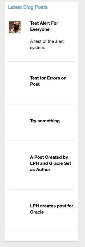

The CSS work is going fine but I'm struggling with how to show the date.
This is in the template.
<li><xf:date time="{$latestpost.postDate}" /></li>
This is the postDate format
"postDate" => "2018-07-11 11:43:22"

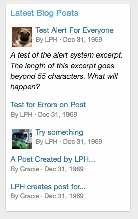

But all posts are returning December 31, 1969WordPress Latest Blog Post Date Wrong.webp
You will turn postDate into unix timestamp.
Fantastic!
The strtotime() worked like a charm!
Update: Drats. It's 7 hours off. Sigh.
Update 2: Turns out if post_date_gmt is pulled instead of post_date then the date and time are correct.

Cool feature: If no featured image in the WordPress post then the avatar is shown next to the blog post title.

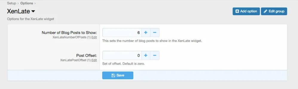

Adding options for the number of Blog entries to show was freaking easy! It's been the easiest step so far.
@Chris D or anyone else,
Update: A positive integer setting doesn't work if the default is zero. It'll set but once increased to 1 then cannot decrease back to zero. I've set to integer but then there can be a negative. Any suggestions?
Take unsigned int with Format parameters min=0.
