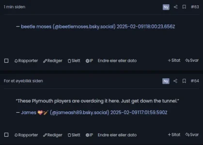

Bluesky embeds look like this:
This is on our forum running XF v2.3.4.
However, on an old forum running XF v2.2.13, the posts are embedded perfectly, even though the media site embed configurations are identical on both forums.
