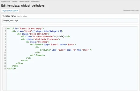

CFMack Active member May 4, 2018 #5 I just ran a few of them. This is what the template looks like: Last edited: May 4, 2018
Chris D XenForo developer Staff member May 4, 2018 #6 ozzy47 said: Does the cron run at midnight to populate the widget? Click to expand... It doesn’t use a cron. CFMack said: I just ran a few of them. This is what the template looks like: View attachment 174622 Click to expand... Do they appear under Birthdays under the Notable members section?
Chris D XenForo developer Staff member May 4, 2018 #8 I’ll check the code but as far as I recall it should be the same. So I can only suggest trying to move the widget to other positions to see if that makes it show. Also try it on an unedited default XF style.

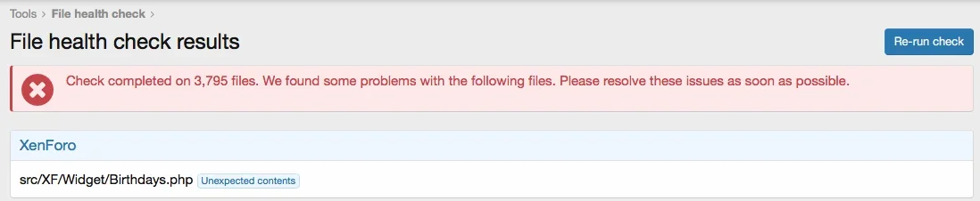

Chris D XenForo developer Staff member May 4, 2018 #11 Just fixed it, if you'd like to patch it yourself, you need to edit src/XF/Widget/Birthdays.php. Find: PHP: $userFinder = $this->finder('XF:User') ->isBirthday() ->isValidUser(true) ->order('username'); Replace with: PHP: $userFinder = $this->finder('XF:User') ->isBirthday() ->isRecentlyActive(365) ->isValidUser() ->order('username'); The previous code was applying a "recently active" constraint of 180 days. We had changed it to 365 days for the member stat, but must have missed it from the Widget.
Chris D XenForo developer Staff member May 4, 2018 #14 Yes it will. Won't be too long until the next release.
