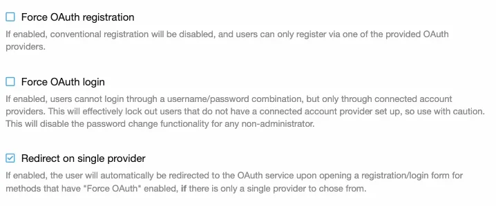

We've already coded the Force OAuth registration and Force OAuth login features into our provider. The question is how to connect an account to an existing XF account without knowing that XF account's password - Does your add-on implement that functionality?

@mattrogowski Just as an FYI - I took a look at the TH Connected Accounts provider, and it actually already does EXACTLY what we were talking about above. There is an option to allow users to associate the connected account with an already-existing XF account. And it works perfectly. I'm not sure if this got added after our discussion or if you simply weren't aware of its existence, but yeah, it works great.
