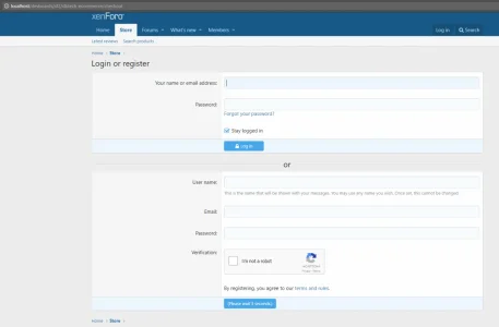

For my eCommerce tool, I plan to support guests adding products to the cart, and for them to be offered the login and registration forms upon clicking checkout. Ideally, I would want to preserve compatibility with 3rd party modifications that may modify the existing login or registration forms.
My initial thoughts are to include the login and register_form templates, while copying the actionIndex code from the Login and Registration controllers.

At face value, this works:
HTML:
<xf:breadcrumb href="{{ link('dbtech-ecommerce/checkout') }}">{{ phrase('dbtech_ecommerce_checkout') }}</xf:breadcrumb>
<xf:include template="login">
    <xf:set var="$xf.options.registrationSetup.enabled" value="0" />
</xf:include>
<div class="blocks-textJoiner"><span></span><em>{{ phrase('or_separator') }}</em><span></span></div>
<xf:include template="register_form" />
<xf:title>{{ phrase('dbtech_ecommerce_login_or_register') }}</xf:title>
I force $xf.options.registrationSetup.enabled off because the registration form is already there, and my own title ends up in the bottom of the template because those two templates have their own title tags.
I've not tested the actions themselves just yet.
