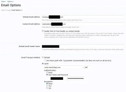

Pretty straight forward actually
I set up a noreply address for the default. This one has an autoresponder set up in cPanel so that if someone replies to an alert they get a "don't do that, you moron" message

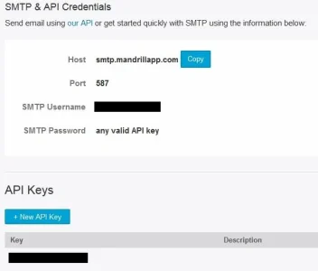

Then set the transport method according to mandrill (username from mandrill, API key for password)
This screen in mandrill gives you the info for the above

done
Working perfect for me right off the bat
