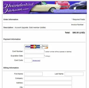

When people upgrade on my website, it does not give them a confirmation page, it just goes back to the home page. Really wish I could fix this!
Everything works but no confirmation page.

No, I'm not upgrading to XF2 anytime soon. How would I go about "back porting" it? I would be happy to pay you to fix it. One other note, I noticed in another software you did, you had the user specify the return URL in Authorize.net. Some users like myself use Authorize.net on several sites, so it's better to specify in the payment form.

No, it's unrelated. Basically there were no way to keep track of the return URL but there are some workaround (hack) now. I will see what can be done and get back to you.
