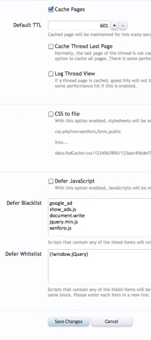

If I turn off the option
It fix the tab but there are still the ugly "jump" when you refresh / browse
with css to file on there are the jump again:
nodesastabs-gif.101010
The point is that with the addon disabled works very fast and without that issue.
Well, now everything is working perfect with [bd] Cache with my actual configuration but with the addon Defer JS disabled.
I'll ask in the thread of Defer JS if there are something to improve this in mobile devices
Thanks for your help Roldan!
Can minify css and CSS to file be used at the same time? I minfy the CSS via the ACP option, what are the advantages or disadvantages?
I also noticed that xfrocks mentioned that most of the overhead is caused by CSS to file, so is having just the cache and not CSS to file helpful more than having both enabled? :o
Yes and should be :).
Only advantages(smaller css file size) and no disadvantages.
I also noticed that xfrocks mentioned that most of the overhead is caused by CSS to file, so is having just the cache and not CSS to file helpful more than having both enabled? :eek:
I really recommend enabling both.

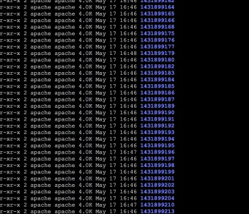

Holy cow - have to uninstall for the moment. Thousands upon thousands of directories in data/bdcache, server bogged down today, trying to troubleshoot. No idea how many directories in here, but watched the scrollback zoom for like 10 seconds:
edit: conflict with TAC DeDos; fix pending hopefully :)

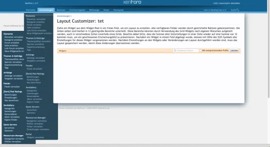

hi
i have some problem. when i activate this add-on , i have some trouble with my xenmig Portal . when i will edit my layout in the Acp , it´s not going because is destroyed . here a pic what i mean
