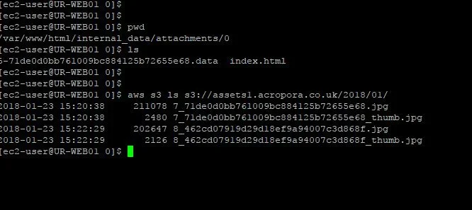

unfortunately you can't do that as the file structure is different, you've have to move them to the data folder first, however i couldn't get this feature to work either it just keeps failing. Even if that did work you've fundamentally changed how the attachments system works with no way of going back to "default", which is a problem if xenforo releases a new version that doesn't work with the addon....

okay so after some further testing, i can successfully move data from default to the the data folder, i can also move it back to default again. However it doesn't move data from s3 to the data folder, so it would appear that the move options don't work for getting data out of s3 regardless of the destination type (data or default).
