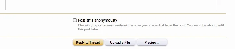

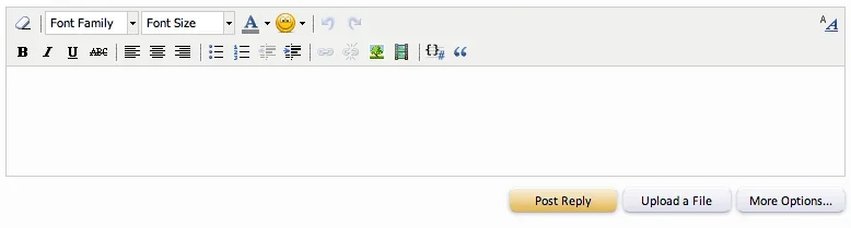

Hi - On 1 forum section the Quick reply is fine!
But Full Reply box show's the Post this "anonymously" option. It should Not display this option + this forum section is NOT showing in the Adim control panel.
ALL other forum sections work and function perfectly, only this one doesn't.
This Forum section is connected to this add-on:
http://xenforo.com/community/threads/surreyforum-xenkingdir-link-business-directory-directory.20706/
Please help as I don't want the anonymous option in this section, nor does it give any option in the Admin area as this Forum section is not even showing with all the other forums in: /admin.php?options/list/discussionOptions
The above issue was solved by making the directory forum visible, and then turning this option off (or on, or something?), and then making the directory forum invisible again
It's not possible to turn this option on/off for invisible forums (I think this will be a rare scenario, and I've been told the work around is satisfactory)
