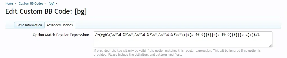

The code that brogan gave worked like a charm no lets see if i can read it correctly am i novice on regular expressions.
/^(rgb\(\s*\d+5?\s*,\s*\d+%?\s*,\s*\d%?\s*\)|#[a-f0-9]{3}|#[a-z]+)$/i
What i read here if someone uses rgb to define the color that he is only allowed to use numbers and two coma's. But how do you limit the to max 3 numbers in the sequence, that not clear to me?
The | i assume is the next part of the regular expression
#[a-f0-9]{3}
If some one put the color up in hex then its limited to numbers and a, b, c, d, e and f. The question here is how the expression knows that 1234567 is not a valid sequence and what is the {3} for
#[a-z]+)$/i
The next one is for named colors you say only letters may be used. But what is the $/i for?
Thank you for learning me new stuff i did not know you needed to use it to make BB Code save.
FWIW I think you may have copied the regex from the screenshot incorrectly.
^(rgb\(\s*\d+%?\s*,\s*\d+%?\s*,\s*\d+%?\s*\)|#[a-f0-9]{6}|#[a-f0-9]{3}|[a-z]+)$
In the rgb case it ensures that 3 numerical values can be entered, separated by commas.
It matches a string that is exactly 3 characters long, and the characters must be one of 0-9 or a-f. 1234567 is not valid because it is more than 3 characters.
There's another bit you missed before that which is similar, but it matches a string which is 6 characters long.
The start of the regex has a ^, this asserts the match must begin at the start of the string. $ is the opposite. It asserts the match must now be at the end of the string.
Typical example:
"#ff0000" will match but
"#ff0000 blah" will not match
The / is the delimiter - there's one at the beginning, too. It's the start and end of the pattern. The i is a modifer. There are others, but i basically allows the match to be case insensitive. In short, this would match, too, despite the pattern seemingly only allowing a-f (lower case):
"#FFFFFF"
