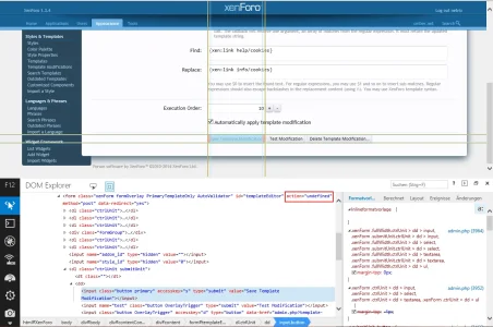

When I try to edit/add a Templatemodification I got the problem that I can't save or test it, cause the HTML looks like this.
HTML:
<form id="templateEditor" action="undefined" class="xenForm formOverlay PrimaryTemplateOnly AutoValidator" data-redirect="yes" method="post">
The action is undefined. This HTML is generated by this code.
<xen:form action="{xen:adminlink '{$prefix}/save', $modification}" class="AutoValidator" data-redirect="yes">
I've inserted this code below to test the thing for the action argument which worked just fine.

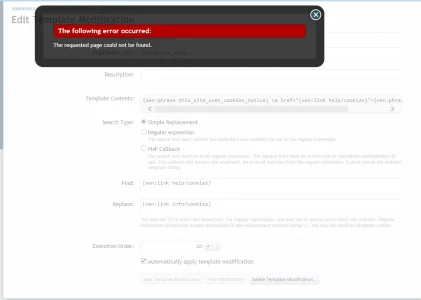

When I try to save a templatemodification I get this message.
Tested with Firefox 31 and Internet Explorer 11.
This is what the Dev Tool shows me with the listener option set to false:
