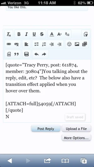

The editor box
You mean the toolbar buttons... AFAIK those are from a sprite sheet and the toolbar button sizes are controlled in your ACP - Style Properties -> Rich Text Editor -> Editor Toolbar Button.
You can probably create a new sprite sheet with larger icons and increase the size of the buttons - but you will probably also have to edit editor_ui.css to pull in the correct new sprite sheet locations.
