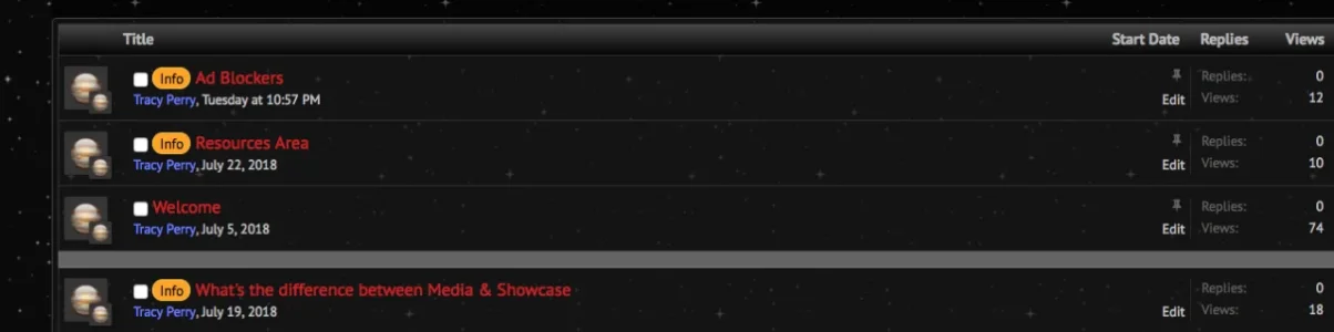

You mean like this?
Noneof those threads have a reply (and they shouldn't as I'm the only one allowed to post in those. If you notice, my small avatar is shown in the corner of my normal one.

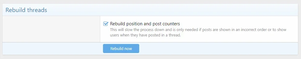

We had this issue @ DBTech after importing from vB4. For some reason, threads that were created on vB4 would randomly display the "has posted" avatar, I would run the rebuild threads with the box ticked, it would fix the issue, then 5-10 minutes later the avatar would come back.
No new threads going forward has exhibited the issue thus far, not that I've noticed or had reported.

Thanks Brogan and Fillip for the tip/info.
It is really hard to track down as it does not happen each time. I've instructed users to send me screenshots and note anything special.
I'll do the rebuild over the weekend.
