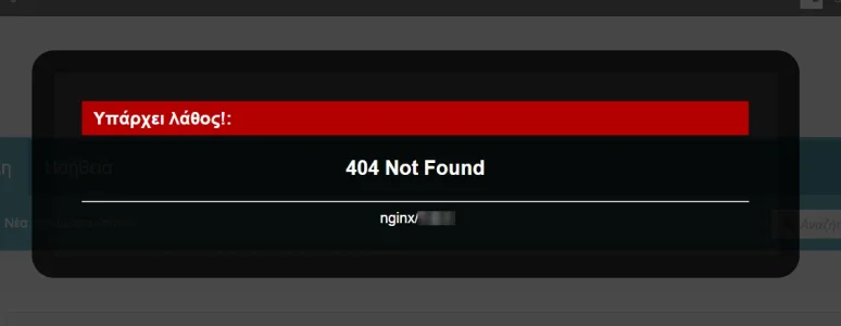

Hello,
The URL domain.com/account/avatar returns 404 Not Found. There is nothing related in server logs though.
Any help solving this please.
