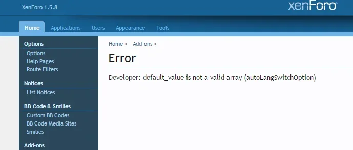

I get an error when installing it...
default_value is not a valid array (autoLangSwitchOption)
When I remove this line, installing works.
But then I can no longer change the language. I have to clear the cookie in order for it to work.

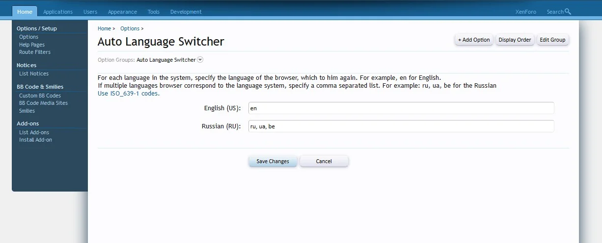

I have set up the addon after deleting the whole line with a:{1:en},
then i have seen the options to add language-codes.
Here i would like to say:
use german for de,ch,at
use english "for all others"
Is the solution to setup english as default language for guests and define only
use german for de, ch, at ?
Yes, seems to be ok.
