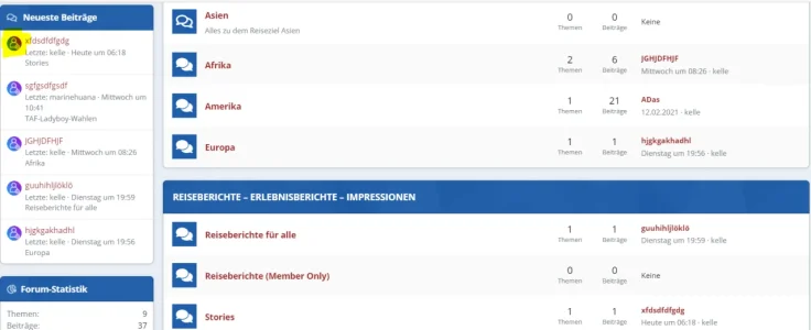

User:
Guest:

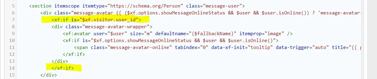

2. The next template is: message_macros
find:
<div class="message-avatar-wrapper">
and add again before :
<xf:if is="$xf.visitor.user_id">
close this tag again with:
</xf:if>

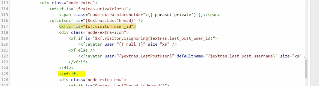

3. Next template is: node_list_category
find:
<div class="node-extra-icon">
</xf:if>

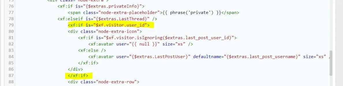

4. next template is: node_list_forum
find:
</xf:if>

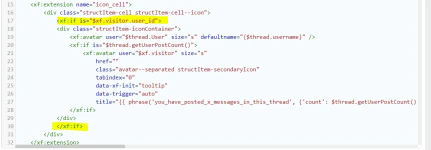

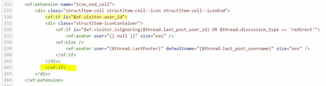

5. next template is: thread_list_macros, there is two places.
find:
<div class="structItem-iconContainer">
</xf:if>

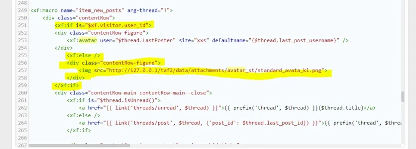

second place:
find:
<div class="contentRow-figure">
</xf:if>

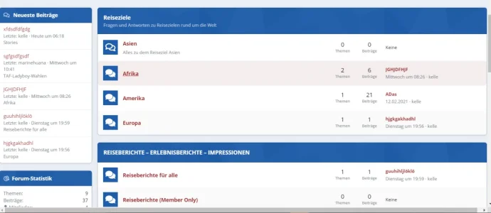

After the modifications it looks like this:
This is good enough for me.
If you still want to display a standard avatar, you have to enter
</xf:if>
before you start:
</xf:if>
use the following code:
<xf:else />
                <img src="path to your image">
            </div>
It is important or easier to give the newly inserted div the same class as the div you are hiding for guests.
In the example:
after that, it looks like this:
