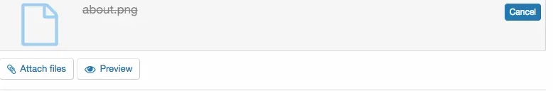

I can not use the attach button in forums. Here is a screenshot...
Is there any idea what this is....It not working with zip files also......

This is most likely a server issue. Can you upload an avatar? Are there any error logs in your control panel? If not, open your browser console/developer tools and try to upload an attachments -- do any errors appear?
I have no problems with avatar, and when i use the button on the top of the forumbar, (the little image picture button) i have no problem with uploading pictures. And just to try it out i have tested this on several servers and with the same result. I going to try this with the conole now, and i come back with a repport.
Here is what i get from the console:
Failed to load resource: the server responded with a status of 403 (Forbidden)
attachment_manager-compiled.js?_v=57704fa6:2 POST https://eivinds.website/index.php?a...e_id]=2&hash=ab5060086c57b3063cbf8f1b87538d85 403 (Forbidden)

What was it you were doing, working in the ACP, FTP, server?
First thing I would try is uploading all the XF files for the version you were running back to your server.
If that does not work, restore your most recent backup.
You're a genius Ozzy. This did it. Thank you. For my main site, I simply published the site over with the Weebly builder.
