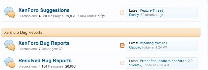

In ff 25 - the arrowWidget appears to be getting to be getting cut off
It displays completely if arrowWdget has a margin-top of 0

I figured it out...this problem only surfaces for the XenVetana style which probably means that the change in font is the culprit.

I have reported it a few times in the past to Kier/Mike as I use the XenVetana style exclusively.
IIRC, it's a line height issue with FF only - Chrome is fine.

Indeed.
.Popup.subForumsPopup line-height: 14px; would fix it in ff and I believe would have no negative consequences in chrome
