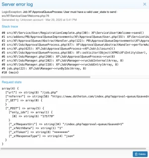

Yep - invalid user state.

The plug-in works fine - [XB] Approval Queue Improvements 2.1.3 Patch Level 3
But when I approve a valid user (after emailing them to confirm they're a human) the User registration remains in the queue.
I'd simply use the tool to delete them all, but the only option with the add-on is to do that for all the entries. I can filter them down I suppose to the one I want to delete, but that doesn't solve the issue of Xenforo not removing the one I've approved.
So maybe the add-on is interfering - I'll remove it and try again.
Sure enough, that worked. Disabling the add-on returns to normal behaviour.
