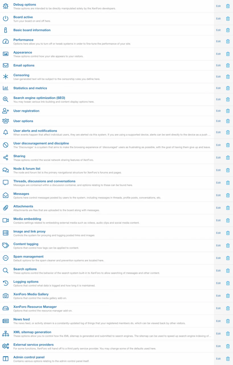

Admin options UI tweaks
We already ship a huge number of options with XF and the list of option groups only gets more crowded as you install more and more add-ons. It certainly sometimes feels like you "can't see the wood for the trees" so we've now given developers the ability to associate Font Awesome icons to their option groups just to give a little bit of visual separation between an otherwise long wall of text.
