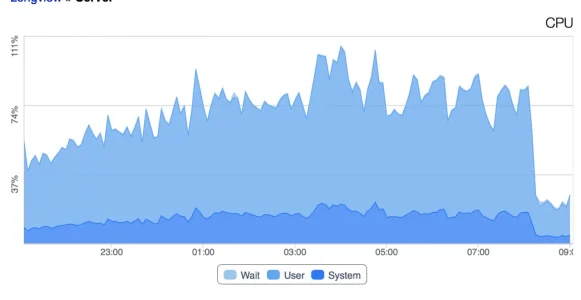

Apache 2.4 + PHP 7.1 + PHP FPM = WOW for CPU
I recently changed hosts, switching hosts decreased the timing to generate a page by nearly half. I then switched to 7.1 (from 5.6.12) and enabled PHP_FPM, and decreased the timing by another 40%. From the old host to now my site is a minimum of 3x faster, and I'm still not done tweaking, :)
