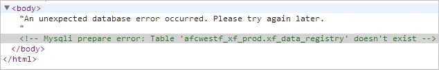

Yesterday my site went down and all it says is "An unexpected database error occurred. Please try again later".

Here's your problem:
You should contact your host to determine why the table is missing.
Tables don't disappear on their own so you will need to investigate whether it's an add-on, malicious activity, or server/host related.
