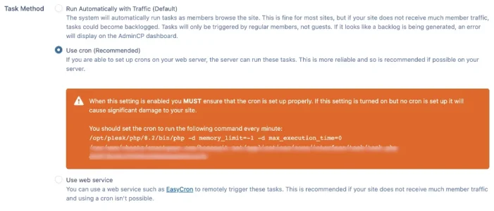

After helping out another admin, it was discovered that his hosting provider does not allow any CRON jobs to be created at a less than 5 minute interval. Apparently (from some research) other major hosting companies do the same.

Thing is, most of these just perform HTTP requests to a given URL.
They work with the activity based trigger.
If you send a HTTP request via one of these services once per minute, it will count as activity and trigger the cron jobs to run…

I
Using Easy Cron just needs activity trigger to be left as it is and when logged into Easy Cron just add the Url like so:
https://websiteurl.com/job.php
You can test it to make sure it works and then you're done. I run this on my three sites, and it works great. I use the $24 a year tier and that gives me 8,000 executions per day, in reality I only use 4,320 so plenty of headroom. For example, executing every minute is 1440 EPD. Saves a lot of head scratching lol. Hope that helps.
