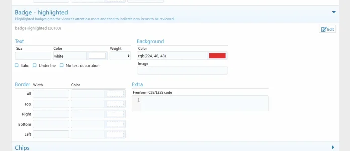

ACP > Apperance > Styles > [your style] - Style properties > Badge - highlighted

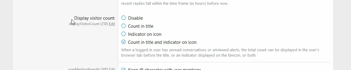

ACP > Options > User alerts and notifications > Display visitor count
I changed the color in js\xf\core-compiled.js yet the color still remains red on the browser tab.
I also get a warning for the filehealth check, so the change is applied (shouldn't be a caching issue).
Ah, right, stupid me.
Well, strange. Now it seems to be working, the color has changed. Also in the js file the change can be seen. Thank you.
