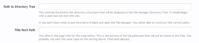

For the life of me I cannot figure out what is supposed to go in the Path to Directory Tree box. I've tried several things that I think it should be but nothing works and it gives me an error. Can you please give me an idea or sample? I'm trying to make it open within my root directory but it doesn't seem to work.
If I use /home/me/public_html/library/FileManager I can get in, but how to navagate to my root directory instead?

It looks like you would want just /home/me/public_html. You don't want to go all the way down to FileManager.

The only way it comes up and works is if I use that long path to the FileManager folder
Works
Doesn't work
Doesn't work
If I leave it blank it just times out with the below error...
Fatal error: Maximum execution time of 30 seconds exceeded in /home/me/public_html/library/FileManager/Model/FileManager.php on line 55

Try /home/me or /home or just / . The worst that can happen is another time out error.
I had already tried all of that and the only thing that works is the long path to the FileManager folder.

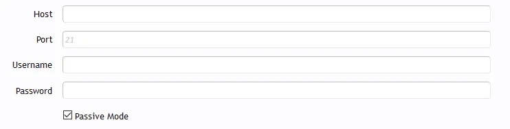

I'm guessing you might need to add the below fields to the File Manager Admin settings.
I think it does actually make sense because within the library folder there is the .htacess file which blocks activity into that folder directly and then the permissions of my public_html folder cannot be altered because the hosting company runs a cron every night to set all of the permissions of the public_html folders on the server back if you change it. They do it for security reasons. The only way around it might be to add the login fields above.

This is a really cool add-on and I think if you figured out a way to add those fields to the File Manager Admin settings so it would log on when it comes up it would probably override everything and solve the problem. It would just need to connect like an ftp client application.
I don't think any kind of log in for ftp would affect AJAX.
