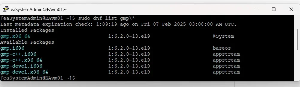

I made sure that gmp was installed:

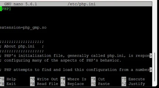

added this to php.ini
saved then rebooted...
Xenforo admin home page still says:
gmp support: No
