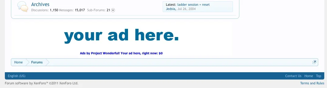

It works fine for me:
This must be a problem with your custom style. Try it on a default style to confirm this.
