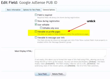

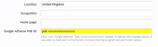

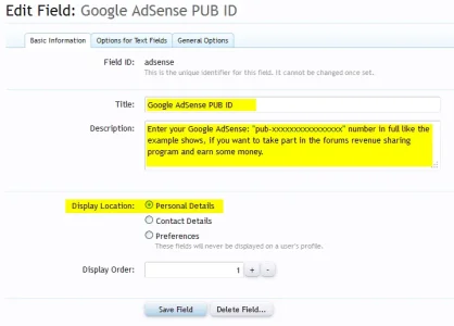

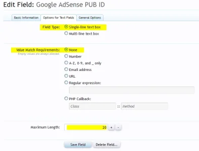

This works perfect, here are some screen-shots taken while setting it up just now.
What the custom field looks like:
Setting up the custom field:
One:
Two:
Three:

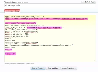

Google AdSense code needed in "ad_message_body" template complete with styling class:

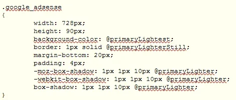

CSS Class added to "EXTRA.ss" for styling class used:
The MOZ shadow effect code can be removed, I just threw it in there to show off what can be done with adverts and styling them.

This will only work if you use TWO (not one) custom fields added used for both AdSense "CLIENT" and "SLOT". Two things worth keeping mind also here, the person on your forum filling in these two fields must first make "double sure".
1: They have their AdSense account set-up to show ads on any domain (otherwise they won't make a penny) from any click-thru's. Or at least have your domain listed as allowed.
2: They (MUST) create a 728x90 banner on their account they grab the CLIENT and SLOT number from, that's if your using the same size of banner for ads revenue sharing on your site. However, the size doesn't matter as much if your not using styling wrapped around the ads.
For example: The SLOT number dictates the size of banner they get displayed they created on their account. So if they take the SLOT number from a 468x60 banner, that's the size of banner they'll get displayed on your forum.
