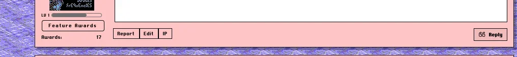

I there any way to have member awards appear below the message block? From below "Report" to "Reply"?Screen Shot 2020-12-11 at 9.30.57 PM.webp
