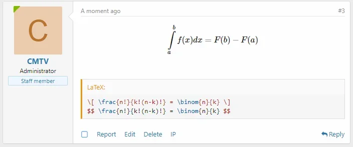

How come latex does not render and just color? Im using mathjax js to render them.
I guess you need to prohibit MathJax to render LaTeX code in pre.bbCodeCode code elements. This can be done vie configuration .js file.

Just to clarify, I have mathjax on XF 1.5 and plan to remove them when moving to XF 2. i have a test site with xf2 and try to see how it will render. It appears from your example that prism will not render latex. Can you confirm?
It seems you are right. MathJax do not touch the code inside pre code elements. No need to edit it's config file!
MathJax renders math: LaTeX code -> Fancy math
PrismJS simply highlights the code (including LaTeX code). No render work. It serves a different purpose.
