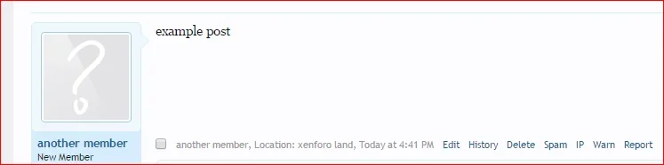

Thanks Wang, I hope this illustrates it: trying to add the message poster's location before the timestamp: in this example adding 'UK' as the poster's location:

This will be the result. Note that I have hardcoded the word location. You can also create a proper phrase for it.
