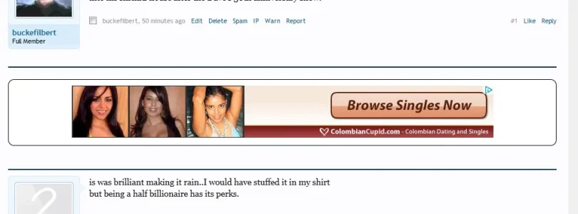

i thought I'd chime in. I placed an ad after the 1st post of every thread but if the 1st post was real short the ad would push into the post. I didn't like how it looked & fixed it. here's my code for ad_message_below w/ an explanation
  • the first if line is limiting this to threads (not PCs) and putting the ad after the 1st post of every page.
  • the <li> tag after that sticks a break after the post. (as if it's another post) This way the ad is never next to the avatar
  • the <div> after that is just some styling to put a box around the ad & is not necessary
  • the next if line is blocking the ad for anyone in the 9, 12, & 20 usergroups w/ a message that the ad was blocked.
  • after the else leaves all the other usergroups that do see ads. you could place your ad code there but I thru in another if. this if checks to see if we're in forum 6, the adult forum & makes sure NOT to display adsense there. it instead displays a adult ad.
  • after that else leaves all the non-adult forums & displays the adsense ad.
  • I'm not using after the next else but that would put code between all other posts & PCs I left it while I still plan out my ads in case I decide to put something there but probably won't.

with the default sex skin, here's the result. it's placed after the 1st post of page page of eery thread that is NOT in forum 6. most members see this.

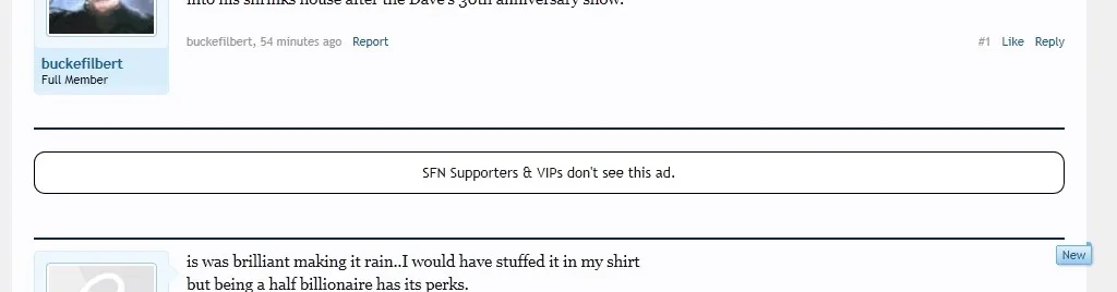

the ones in groups that do not see ads, see this
