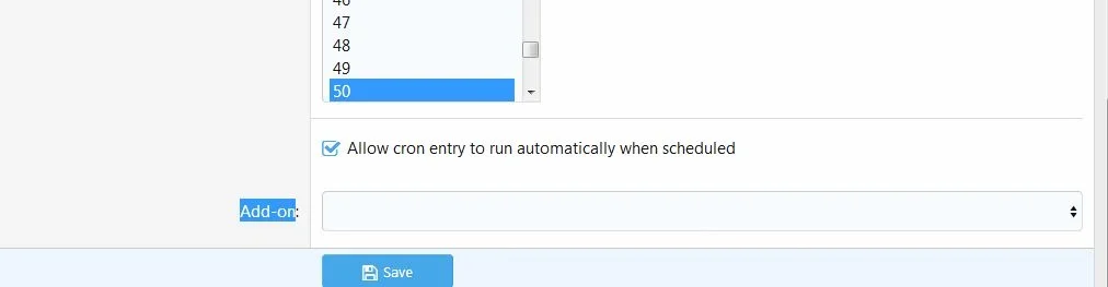

If you create it as normal and then look in the xf_cron table in the database does it have a value under addon_id?
Ok I enabled debug mode
The Add on is blank. I am sure it must have been blank earlier also as the cron was set in non debug mode
Yes the column is blank.
Last time also I had set in non debug mode so I presume that the col would have been blank
