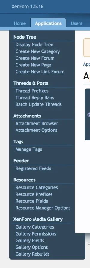

Under the Applications tab, do you see the XenForo Media Gallery section, as pictured at the bottom of this screenshot?

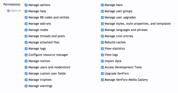

If not, if you go to Users > Administrators > (Your username) are you sure you have the "Manage XenForo Media Gallery" permission (bottom right corner)?
The only thing that would stop the "Gallery Categories" link showing is not having the "Manage XenForo Media Gallery" permission.
