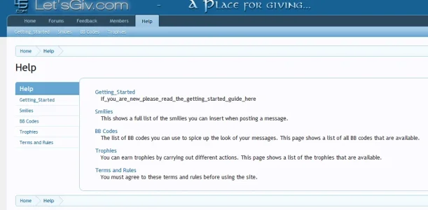

How do I avoid having _'s appear?
HTML:
<dt><a href="{xen:link pages/gettingstarted}">{xen:phrase Getting_Started}</a></dt>
                <dd>{xen:phrase If_you_are_new_please_read_the_getting_started_guide_here}</dd>
                </dl>
                </xen:if>
    <dl>
        <dt><a href="{xen:link help/smilies}">{xen:phrase smilies}</a></dt>
        <dd>{xen:phrase this_shows_full_list_of_smilies_you_can_insert_when_posting_message}</dd>
    </dl>
    <dl>
        <dt><a href="{xen:link help/bb-codes}">{xen:phrase bb_codes}</a></dt>
        <dd>{xen:phrase list_of_bb_codes_you_can_use_to_spice_up_look_of_your_messages}</dd>
    </dl>
    <dl>
        <dt><a href="{xen:link help/trophies}">{xen:phrase trophies}</a></dt>
        <dd>{xen:phrase you_can_earn_trophies_by_carrying_out_different_actions}</dd>
You have to put the _'s in or it gives you an error but the _'s show up for my description and not the others...

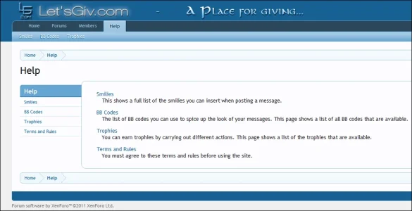

Looks fine to me.
As I said above, I suspect you have changed the phrase titles without creating the corresponding phrases.
that might be it... I just did everything suggested in the first post... pardon my ignorance...
How do I add the phrases?
Everything looks fine on my end except the _'s
here is the code i added in help_wrapper
<li><a href="{xen:link pages/gettingstarted}" class="primaryContent">{xen:phrase Getting_Started}</a></li>
and to the navigation
<li><a href="{xen:link pages/gettingstarted}">{xen:phrase Getting_Started}</a></li>
I just took out the
<xen:if is="{$visitor.user_id}">
</xen:if>
because I figured that was what was causing guest to not see the section.
also sorry Brogan... I just don't know what you mean by corresponding phrases... i will read that link you sent... Other then that can you see it now on your end?
You are referencing a phrase which doesn't exist: If_you_are_new_please_read_the_getting_started_guide_here
The code needs to look up that phrase and return the corresponding content.
Create a new phrase in the Phrases system using that title and the content you wish to display.
