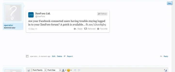

Someone said something about embedding tweets so here yah go.
Media Site ID: twitter
________________________________________
Site Title: Tweets
Site URL: https://twitter.com/
Match URLs: #twitter\.com/(\#\!/[a-z0-9-_]+|[a-z0-9-_]+)/status/(?P<id>[0-9]+)#si
Embed HTML:
HTML:
<none>
___In advanced options___________________________
Regular Expression Matching: Use 'Match URLs' as PCRE regular expressions [ Checked ]
Embed HTML Callback: MediaSites_Twitter :: buildEmbed
Now to adjust the starting point for the tweet, go to appearance/templates in your ACP.
Find template: EXTRA.css
add the following:
.twp-container {
    top: -120px;
For reference this is the twitter callback
PHP:
<?php
class MediaSites_Twitter
    public static function buildEmbed($mediaKey, array $site)
        // CAPTURE WEB PAGE
        $json = file_get_contents('https://api.twitter.com/1/statuses/oembed.json?id=' . $mediaKey . '&omit_script' ,true); //getting the tweet info
        $decode = json_decode($json, true); //getting the tweet info ready to display in a readble fashion
        $finalHtml = $decode[html];        // decode the embed html part of the array
        return $finalHtml;                  // return the decoded string
I will work on making this better...please bear with me.
  • twitter.zip
that has something to do with the twitter widget.js... that is what this line meant before...
:) I'll post up as soon as I figure out the fix.
changing the css to
.twp-container {
    top: -70px;
should just about split the difference for now...you can try that until I figure out a better way to fix this.
