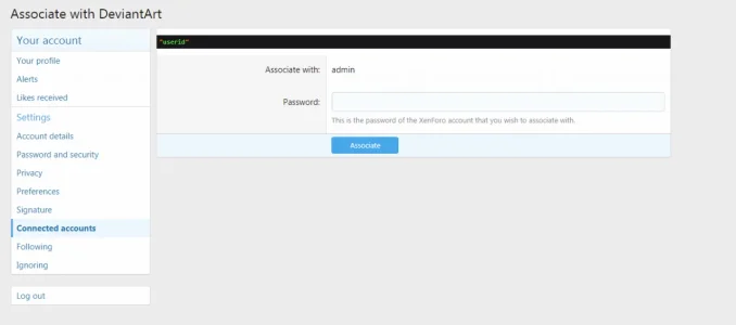

If I start doing a check in the control panel, then everything is fine, I start to make an association with an external account, I get an error. It does not matter what value is in the function: public function getProviderKey(). When debugging, the browser console returns a json with an error.
Debuggind getProviderKey and the null
@Chris D, The error is still the same, I decided to take a break from the implementation of Vkontakte. Implemented DeviantArt, everything works and connects without problems and also when testing outputs a name and avatar.

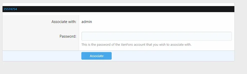

The key is also transmitted
PHP:
    return $this->requestFromEndpoint('userid');
And result:

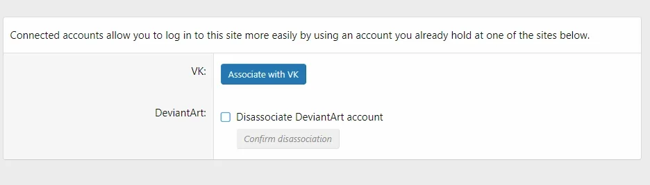

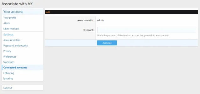

When you bind vkontakte get:
https://vk.com/pages?oid=-17680044&p=getProfiles
https://vk.com/dev/auth_sites
state is not passed, but in XF 1 it was transmitted and possibly because of this.

I don't think you should be returning a hardcoded string in getProviderKey... I think you're supposed to return the unique ID for the user given by the remote provider?
Liam
What do you have returned by the getDefaultEndpoint() method? As far as I can tell from the documentation the correct param to go for is uid rather than userid.
