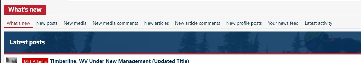

I tried that, but it doesn't show any sidebar :( ---> What's new: Sidenav
However, the overview position is working ---> What's new: Overview
There is no sidebar in What's New, it's a sidenav (to the left)... you must adjust your display settings for What's New Navigation to be on the left instead of on top. One of those weird things, I also wish it was a right-side bar.

Here is the setting:
What's new navigation style
Tabs
Side navigation
This controls how the navigation is displayed in the What's new section. Side navigation works better with more sections but requires more space.
Thank you for this!!!
I found it in: Appearance > Styles > StyleName - Style properties > Miscellaneous
I wish it was an option to simply add a side-bar and keep the tab navigation, but this was a really easy fix so we could place a few ads, etc. on a very active page.
