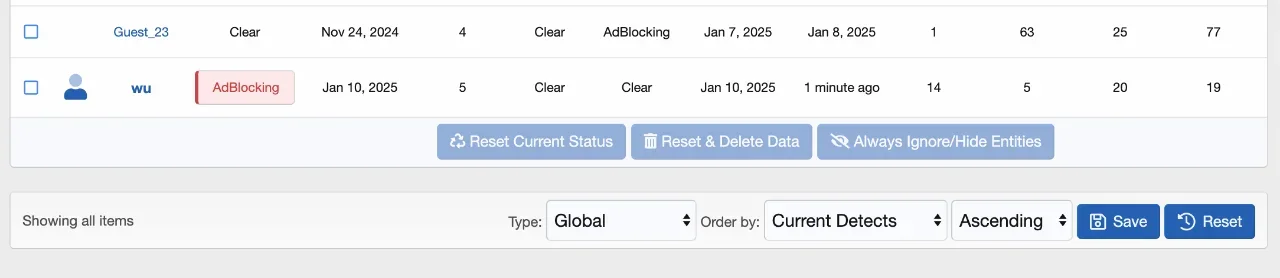

Just use the filtering bottom-right of the form, as shown below:
Also I just wonder if I’m not understanding the tool very well so I don’t want to miss out on any features.
This is not working for me.
If I set Global, Current Detects, Ascending ... then click Save (correct?) ... the results are still a random-looking list.
I am not putting anyone in a special user group yet. Maybe that’s it?
Right now I just want to look at the data and see how many users are using adblockers.
The power of the addon is creating a usergroup and having the addon switch users to that usergroup when they're caught using adblock extensions. Then, persuading them to disable their adblock extensions so they can have the "adblock usergroup" restrictions removed.

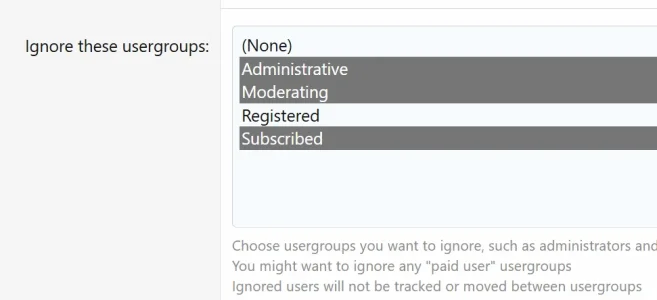

Just to confirm, you have ALL of your paid memberships in the "Ignore roles" of the add-on?
The system checks the "ignored roles" whenever a UserGroupChange is initiated. This is initiated after a user is upgraded, if the role change groupId is in the ignored roles then the "detected" entity is completely deleted for that user:

So before I wade in much further I just wanted to ensure you hadn't possibly created new paid membership roles and forgotten to add those to the "ignore roles" in the AdBlock Tracker plugin.
All of my paid memberships go into the Subscribed User Group
Thanks for your feedback.
After quite a bit of testing I found the issue and have run multiple upgrades with expected results.
Previously, the finalSetup in the upgrade was running in the middle, just prior to the completion of an upgrade. Thus, when checking for the "ignored roles", it didn't actually exist in the secondary_ids yet, and therefore the deletion/removal logic wouldn't fire.
I'm packaging an update now that should resolve this nagging issue.
