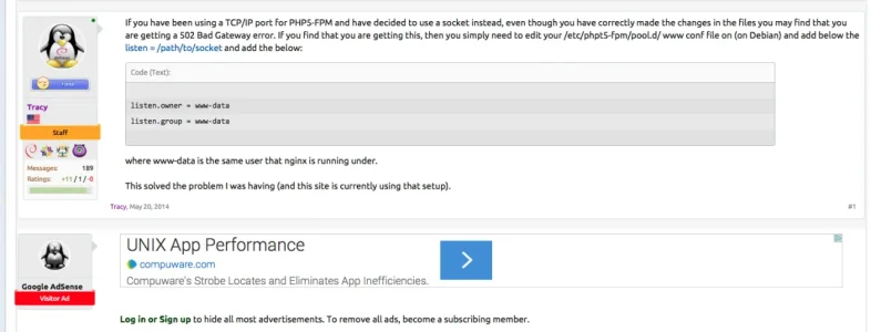

The ad_message_below should be placing the ads something like this:
