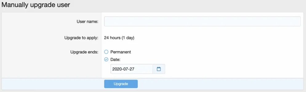

I think this issue is exclusively related to manually upgrading a user, i.e. this form:
This form somewhat ignores the length values set when you create the upgrade. It does use that to set a default, but of course it isn't particularly precise because it only supports the date and it doesn't support a particular time.
The same behaviour would occur even if you somehow had a way of setting the expiry time as "24 hours".
So the next question is - are you planning to upgrade a lot of users manually? If not, and this was just for testing purposes, you can mostly ignore it as a design issue due to how our manual upgrade form works. Upgrades done via a normal purchase will get the full 1 day / 24 hours as you would expect.
Awesome thank you so much for clarifying this was makin me go nuts trying to figure it out. I do plan to manual upgrade some people but i guess im gonna have to modify it through db but thanks
