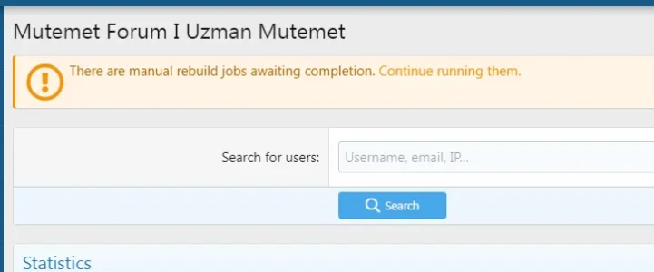

Now I get the error when I say ban bulk user (17)
Mutemet Forum I Uzman Mutemet
LogicException: Attempted to set 'is_banned' while a save was pending without forceSet in src/XF/Mvc/Entity/Entity.php at line 605

It hangs because the query is not executed due to error.
When I say continue, the error persists.
