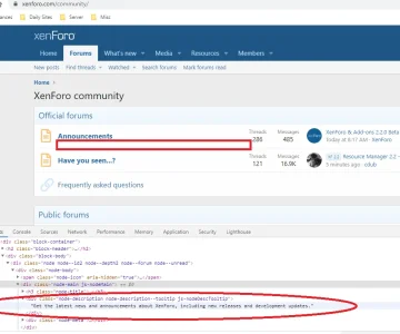

update the description in the oval to something VERY long so it line brakes.
in the rectangle, you will see this text show up and if it's long enough, it shifts to add the 2nd line. It will, then disappear and thus go back to 1 line when you set a slow network in dev tools when the css/js kicks in to make it a tooltip.
