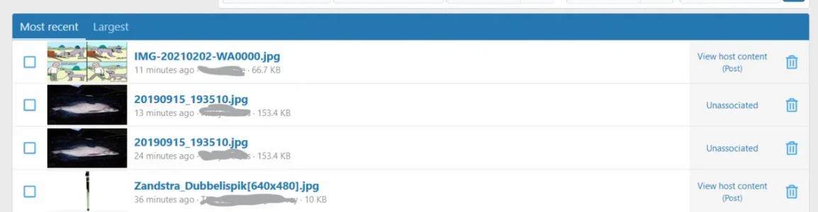

When I look in the ACP I can see the image within ACP>Content>Attachments but it has 'Unassociated' alongside it:
Please can anyone shed any light on why this happens and what to do to prevent it?

I think it may the same issue as you are having. This is what I see under attachments

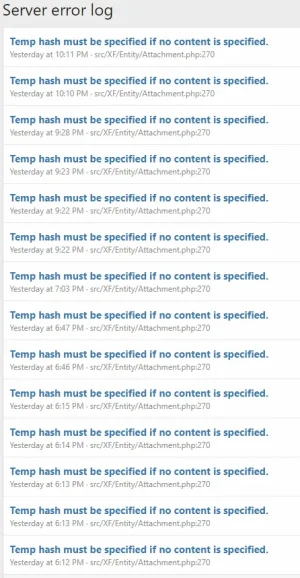

and it is to do with this error:
Server error log
    LogicException: Temp hash must be specified if no content is specified. src/XF/Entity/Attachment.php:270
    Generated by: DavidUK Feb 3, 2021 at 11:59 AM

I noticed what appears to be the same error as the one posted above, yet it looks like it was only generated by one user uploading attachments which failed to associate, while the error was not logged when others ran into the same issue. It also now looks like the issue may have occured before the upgrade to XF 2.2, as there is a post which was made several days before the upgrade which contains attachment links that yield a page not found error. There have also been attachments uploaded after the upgrade which yield that error, but I'm not sure if that was the error that was present when the posts were made, or if it started out as the aforementioned permission error, and then changed to the page not found error after the unassociated attachments were automatically deleted.

I've also received a bunch of these errors yesterday for the first time. The only change that I've made to my site was updated to 2.2.3 patch 1 from 2.2.2 the night before.
