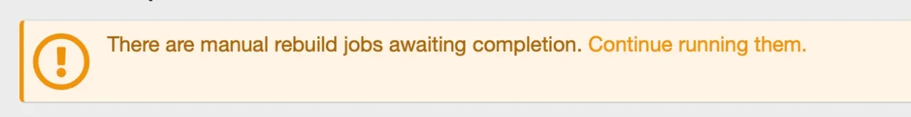

In update 2.1.6, this tank has not been fixed. All the same, at the top of the forum is a strip with a proposal for manual rebuilding.
Press the button - manual rebuild and after half an hour the strip is again at the top of the forum.
Well the bug was a rather nasty server error so I am confident it is fixed.
If there is a manual rebuild job outstanding then the banner will display. This is the expected behaviour.
Once you continue running the jobs you need to leave your browser window open otherwise the job can’t complete.

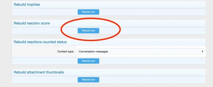

Do I need to go into rebuilding the forum caches and select rebuilding reactions there? Is that all right?
Then wait until the complete rebuild and the banner after this disappears?
Or should I press manual rebuild on the banner itself?

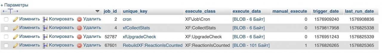

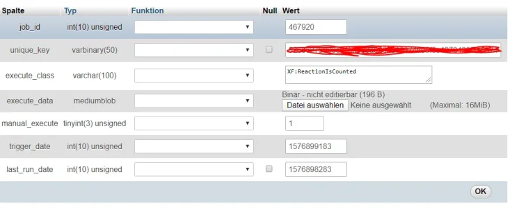

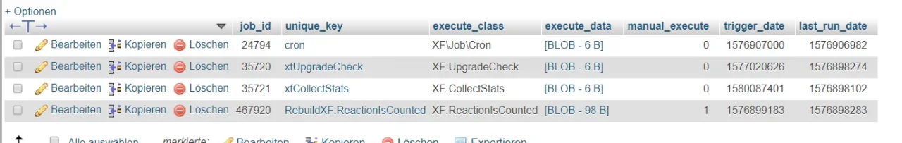

Can you all take a look inside your xf_job table and let us know what you see?

Then when you click "Continue running them" the job will finish properly.
