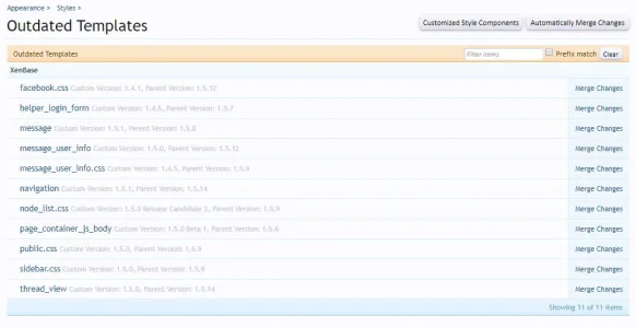

Hi,
Having Xenforo 1.5.14. and was in the process to get help with Upgrading to version 2.latest.
I have 11 Outdated Templates (have had for ages I think) and I also get logged out more or less when I click a link to a page or message etc!?
I was about to get 1 Year of Xenforo Extention and also buy the Upgrade service for $50. But I have been told that getting Xenforo forum software might not
necessarily solve the problem. Thats why I wonder what to do with all of the Outdated Templates?
You use a custom style so you can contact the author for an updated version if you plan to stay on XF1.
If you are going to upgrade to XF2 however, it's irrelevant as they are no longer used.
Being logged out is typically due to your site being available at different protocols and domains - e.g. http, https and www, non-www.
See point 19 here to resolve that: https://xenforo.com/community/threads/frequently-asked-questions.5183/#post-180456
Who was helping you with upgrading - neither of those issues are really related to upgrading and aren't blocking issues.
